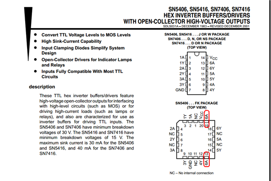

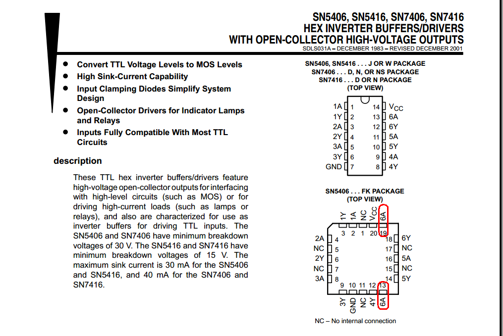

SN5406 - Datasheet error?
please advise on what is on pin 13, should be “4A”, is this correct?
T
hanks.
