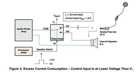

I would like to ask the SN74LVC2G157 Icc.
Does SN74LVC2G157 have the configuration that this device flows excess current(Icc) when the voltage of pin 6 and 7 are lower than Vcc voltage?
I found the information that the analog switch leads to an excess current draw from the V+ supply pin when control input Voh is lower than Vcc.
 http://www.tij.co.jp/jp/lit/an/scda011/scda011.pdf
