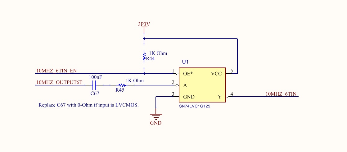

Hello All,
Is there any test data for the SN74LVC1G125 regarding jitter and phase noise figures?
I have looked at some test signals @ 10MHz - looks OK - but was wondering if TI has any test data for
jitter and phase noise.  I am considering using for some 10MHz clock signals - single ended - and wanted
to know if TI has any of these figures.
The part is nice and small - good for compact designs.
Here is an example of the circuit I am asking about:
