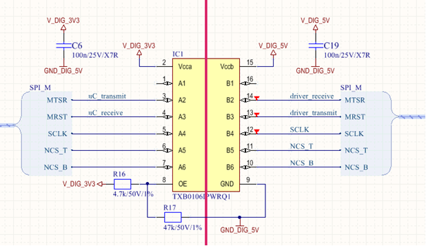

we're using a leveshifter (TXB0106) for shifting a 3.3V-SPI-signal up to 5V. The levelshifter generates a wrong output-signal, as you can see in the attached screenshot. The input-signal was a square-wave-signal with 2Mhz. Does anybody of you have an idea where this could come from? The problem could be measured on every channel!
