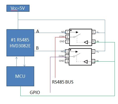

Hi,Team,
My customer is using TS5A3166 to switch RS485 A/B bus.
The range of A/B bus is 0~5V.  V+ is +5V.  Datarate is 9600bps.
The IN pin is +5V.   The analog input is +5V, the ouput is sitll with +1V level when turned off.
Can you help suggest if the part can be used in RS485 bus switch?
And is there bug for TS5A3166?
Thank you.
