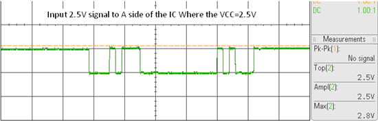

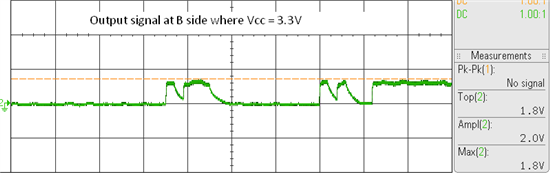

Hello Myself Rakesh,
We are using the TXB0104 to convert a 3.3V SPI Signal to 2.5 and vice versa, But when we are trying the output is not coming as expected i.e. the level translation is not happening properly. The SPI Speed is 1 MHz, Here with I am attaching the schematic of the circuit and the input and output wave forms we captured input circuit.
