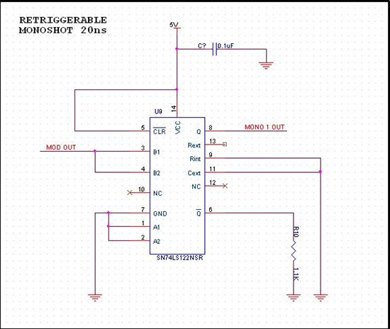

I am using a retriggerable monostable multivibrarator for one of my application. Could you please tell me how to terminate the unused pins of that chip.

     Thank you very much.What about the Rint pin.I am sending the schematic along with this mail.This monoshot is
     part of my pulse frequency modulator.Please check it and let me know.I am sending the TINA TI simulation file and complete schematic along with this mail.Please go through it.Expecting your valuable suggestions

  • Hi Hari. I was looking at the LS123 when I replied before. I thoulght you were asking what to do withe the unused gate.
    You will need to connect either Rint or Rext to get you desired pulse width.  If you use Rext  then you will float Rint pin.
    Look at the application information at the end of the datasheet for instructions on how to pic the R/C values to get the desired pulse width. There is a formula and also charts with R/C vs pulse width.
    If you look at the charts you will not be able to get a 20ns pulse from this part.  We dont have a part that can generate a pulse that small.
