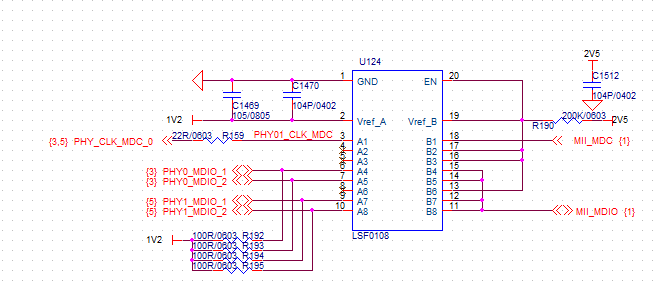

I have a project would like to use LSF0108 to replace MAX13003EEUE
Below is our structure
Behavior : We have four different MDIO source on left side to control one MDIO on right side ,On the left side,4 channels MDIO will not work at the same time, Just one channel work with right side MDIO
My question is
Could I short B4/B5/B7/B8? Is it workable ?
PS. From MAX13003 reference design ,It could short these pin
