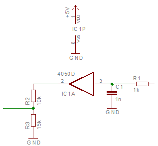

I facing a Problem with a CD4504B. We are using this part to shift from 15V to 3V3. I have noticed that there was a PCN (Link) in 2004 on Page 4 changing the min Supply-Voltage from 3V to 5V.
Is it seam to work in our application with 3V3 but I like to know the reason for this PCN to find out if we have a problem.

  • it does not work well at 3V as it was specd and barely worked at 3.3V. It may not alway work at 3.3V across temp and process. We tried but could not get it to work well in the 3V range so we moved the operating voltage to 5V where it does work.

  • Do you have any recommendation for a level shift from 15V to 3V3?
    The input is signal is an open collector input with a 3K9 pull up to 15V, the signal is not fast but noisy. So I like to have a RC Low pass at the input.
    My best Idea is a simple voltage divider to shift from 5 to 3V3.
    Do you recommend a CD4050B or a CD4504B?

    A fairly simple option would be to use a 3.3V buffer that has internal clamp diodes on the input. Something like the HC125 with a current limiting resistor on the input. This would allow the internal diode to drop the voltage down to Vcc +1VBe
    any of the SN74HC parts would work.
  • Thanks I think we will go for this

    To put my suggestion up front - have you considered using an SN74HC244 (or similar HC family buffer) with series resistors on the inputs? As long as the current into the input clamp diodes is limited (preferably below 1mA) then the SN74HC244 won't "see" a voltage on the inputs higher than Vcc + ~0.7V and it will output at 3.3V (or whatever supply you put on it from 2V to 6V). This would reduce your part count significantly, even though it isn't a perfect solution.
    Some care would have to be taken with the connected 3.3V rail design - most 3.3V supplies don't like sinking current so a shunt might have to be added - but still, a shunt regulator + 1 SN74HC244 and 8 resistors for 8 channels beats the other option IMO.
