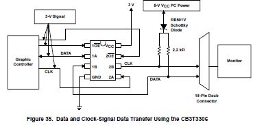

Customer is considering SN74CB3T3245 for the following system.
・VCC=3.3V
・Data rate=100MHz max
・Bidirectional translation between 3.3V and 5V
Is it possible to add external pull up resistors ? If possible, would you give us application information ?
