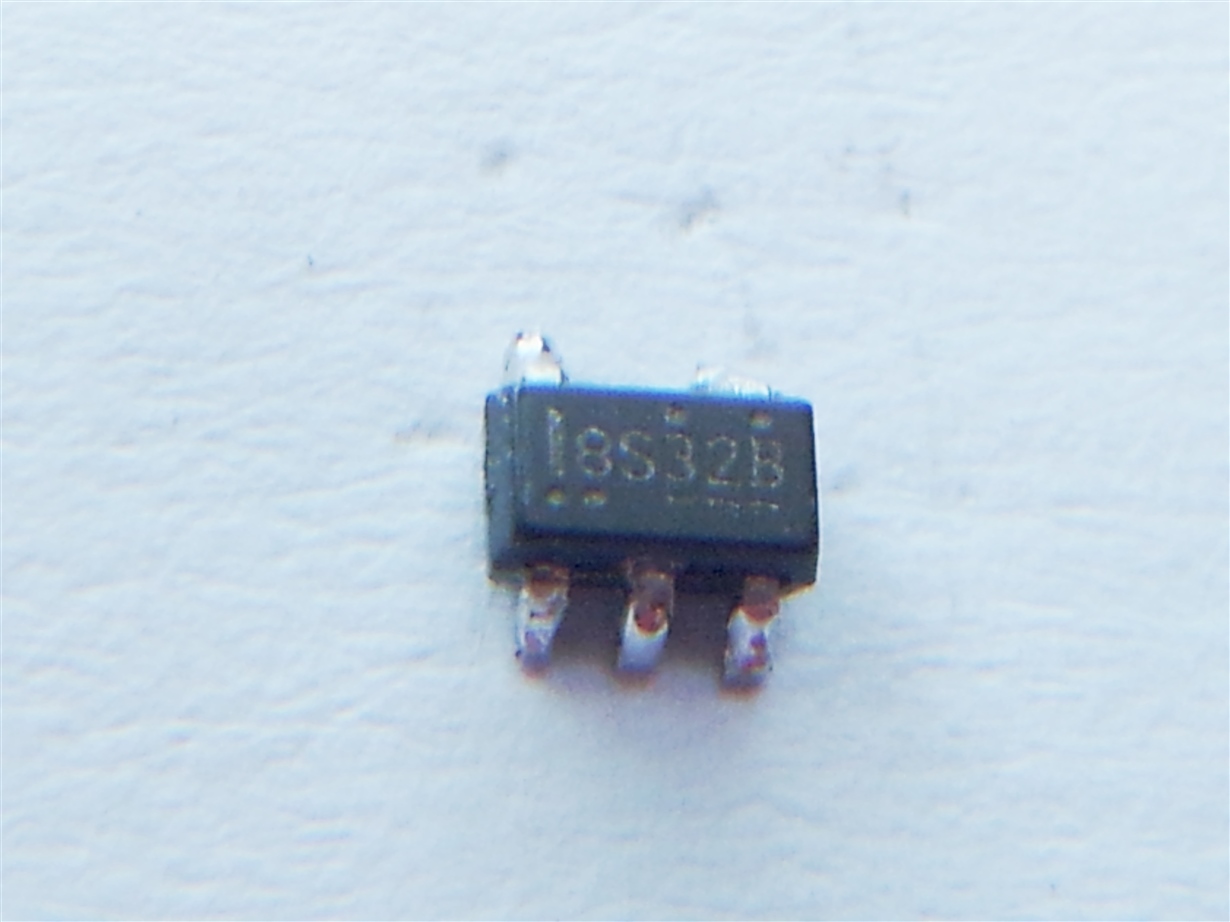

I need to identify a date code and/or lot code on a SN74AHCT1G32DBV part. I have attached a photo of the part. Any help would be appreciated. Thank you!
Steve,
Interesting question. I'll ask around about date codes and see if I can find your answer.
James
James,
Thank you for the assitance. I can tell you the part was on a board manufactured in 2009.
Steve
Steve,
I spoke with our packaging team about your inquiry. The markings on this device and the way the device was made do not indicate that it is a TI part. Our date code convention is unique to our devices.
