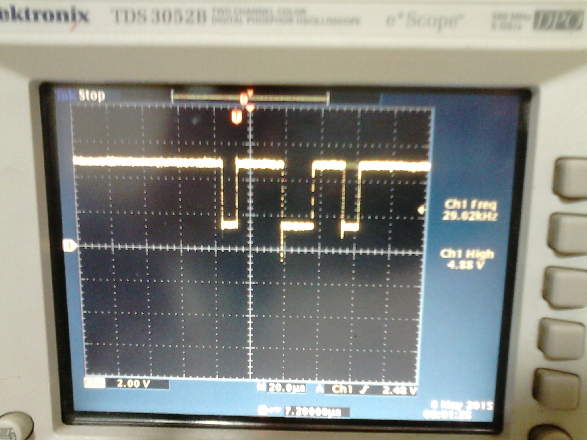

  • Attached are the snapshots of the signals at U19-B2, U19-B4 & U17-1Y.  I could not take for U17-2Y as it was always showing 0.  We are investigating the issue.
    Pl. elaborate on external system driver requirement.
  • Hi Rekha
    Thanks. What is contributing that 1.2V offset in the first waveform?
    TXB-type translator have a 4K series impedance buffer. This part is strong enough to hold the output port high or low during a dc state, but weak in that the 4-kΩ impedance buffer can be easily over-driven by a system driver connected to the A or B port when a bus direction change is desired.
    An external system driver must supply more than ±2 mA of current to reliably overdrive the hold provided by the weak buffer.

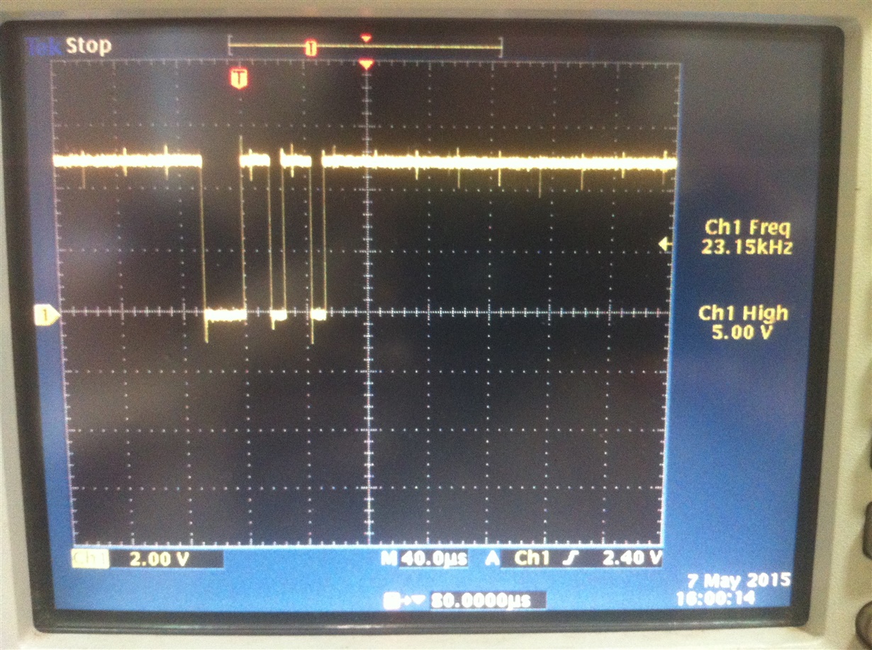

  • Dear John Joseph,
    Following are observations from our side,
    1) At SN751451B input 1B,2B  there is dc level of 2V always,
    2) when we drive external TTL signal of 5V  directly to 1B, levels at 1B is at 5V and Fibre optic is working fine,
    snapshot at 1B with external 5V TTL applied is attached,
    levels are 5V
    3) when level converted signal from TXB0104 is applied at 1B of U17, there is dc shift of 1.2V, as attached in the previous post,
    due to which FO is not working,
    when Direct 5V signal is applied, levels are fine as shown, when level shifted 5V is applied, dc shift of 1.2V is present.

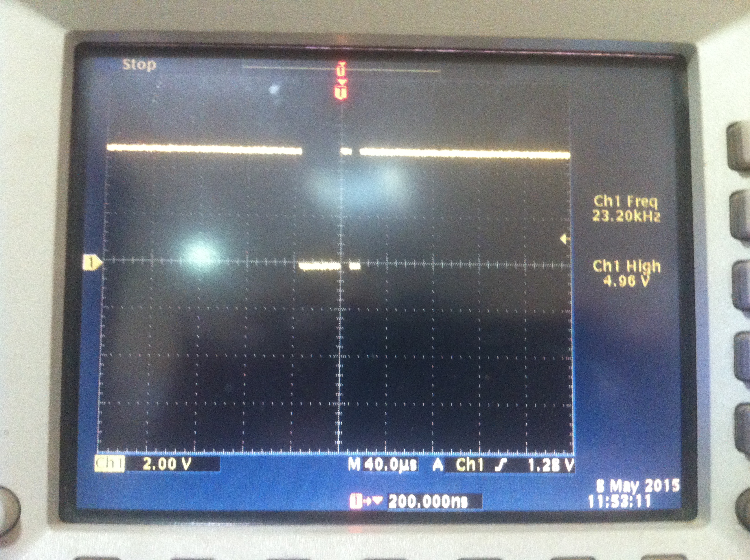

    ans: Input is not floating, TTL signal is connected always during the testing, it is at 3.3V(VCCA) level
    It is to be noted that, TXB0104 is working independetly, waveforms at o/p of TXB with and without driver is attached.
    with driver was attached in the previous post,
    without driver is attached below, its levels are OK,
    vijay

  • Dear Jennifer,
    The issue is resolved,
    We replaced the TXB0104 part with TXS0104E part,
    with TXS0104E waveforms are fine with no dc shift, and fibre optic is also working,
    Thanks for all the support you guys provided,
    Vijay
