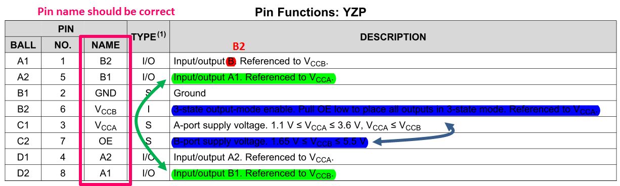

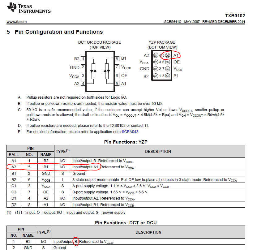

In the TXB0102 data sheet (Rev C, December 2014), on sheet 3 the YZP package pinout in the diagram in the upper right does not match the table below. For example, the diagram shows pin 5 as ball D2 and signal A1, whereas the table lists pin 5 as ball A2 and signal B1 (but the Description lists it as signal A1).
Please determine which is correct for each line in the table and update the data sheet. Thanks.
Also, pin 1 of the DCT/DCU table lists "B" in the description for pin 1, whereas it should be "B2". Please correct that also.
