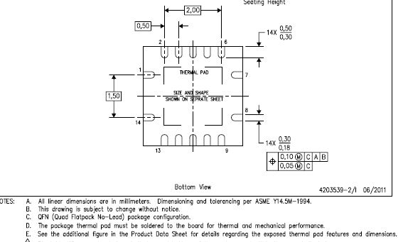

Electrically what should the EPAD be connected to? (I assume ground, but this information NEEDS to be in the datasheet before it can be designed in).
