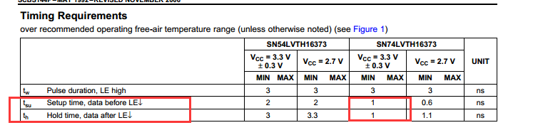

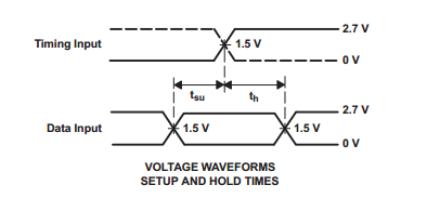

according timing requirement on datasheet,the setup time,data before LE↓ is 1ns(min). Does LE↓ mean the falling edge of LE?
