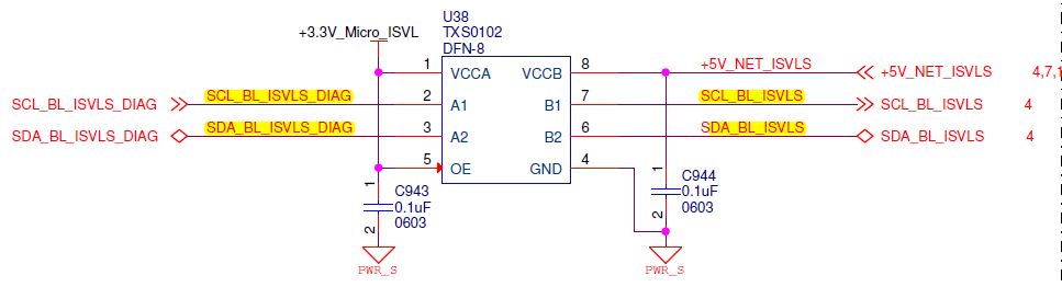

When we first hook-up a multi-board system using a TXS0102 to level shift an I2C bus between the boards, a critical failure will occur causing the TXS0102 to blow-up, but only on 1 system in 25.
Background:
We are utilizing a TXS0102 as a +3.3VDC to +5.0VDC translator for multi-board I2C communications bus.  There are 3 devices on the +3.3VDC side (VCCA) including the master micro-controller and 1 device on the +5.0VDC side (VCCB).
The VCCA side is power from the same rail as the micro-controller and has a 4.75k pull-up on each data line; the +3.3VDC rail will always be powered up completely before the VCCB rail is enabled.  The regulator powering the TXS0102  VCCB rail is located on the same board as all of the VCCA components.  The OE pin is shorted to ground causing the device to be always on.
The VCCB device is a slave micro-controller that is located on the second board.  It is powered by it's own +5.0VDC power rail and each data line has a 4.75k pull-up.  The power going to this slave board is controlled by the master micro-controller and comes on at roughly the same time as the +5.0VDC regulator powering the VCCB rail.  The connection between the boards is a redundant connection scheme meaning that each signal has two parallel wires.

    Can you please send a schematic for me to review?  I am a bit confused about some of the things you said on your post.  You said OE was grounded?  Is that correct?  I will look at you schematic first then maybe we can discuss what might be happening in your environment that might cause this failure.
    -Francis Houde

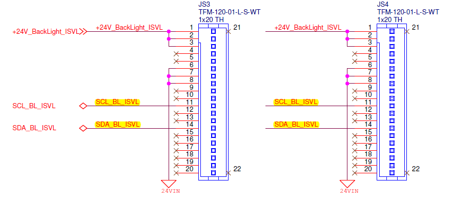

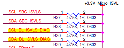

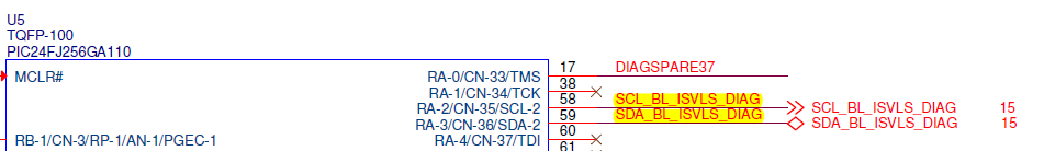

  • Here are some snapshots of the schematic.  From the I2C master perspective, a command is generated by the Master PIC, passes through the TXS0102, moves from the Master board to the Slave board via the 2 redundant cables and then accepted by the Slave PIC.  There are 2 additional slave devices on the VCCA side of the TXS0102 and there are pull-ups on both sides of the TXS0102.

    VCCA Master Micro-Controller
    VCCA External Pull-Ups

    TXS0102 Level Shifter
    VCCB Board-to-Cable Connectors (Mirrored on Both Boards)
