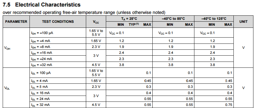

I'm potentially interested in using the SN74LVC2G126 however the datasheet does not contain sufficient data for me to extrapolate the conditions that I would be operating under.
Specifically @ Vcc=2.5V (Io=5mA) what would my V_OL be?
Is there test data or some equation that I can use to calculate this?
