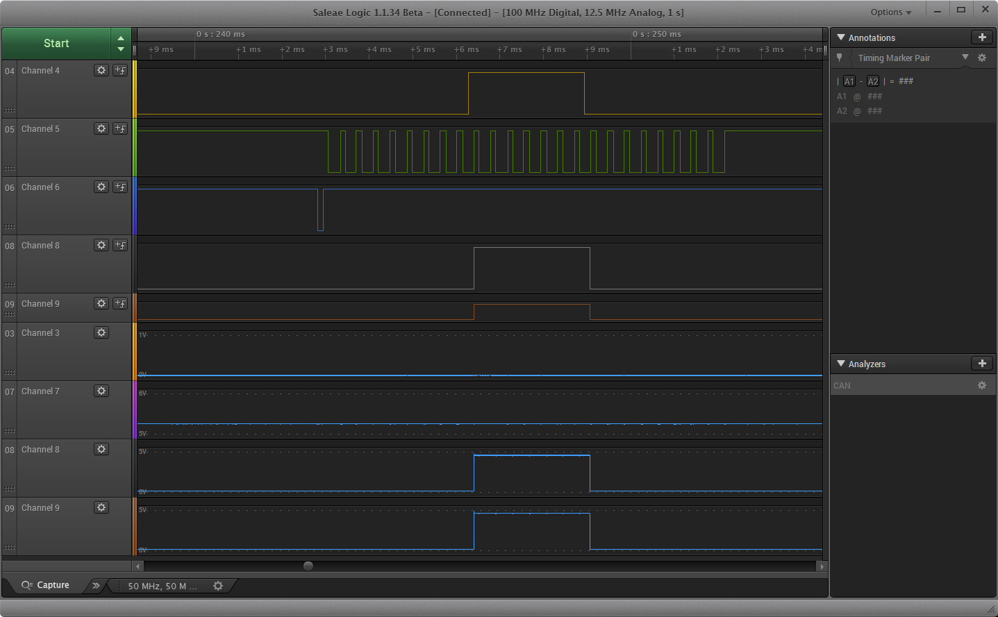

I bought a bunch of shift registers (SN74LS164N) locally and I am trying to figure out of it's just a bunch of bad shift registers or if I'm doing something stupid.  I'm bit banging the output from my RTOS task with GIO on a RM42 Launchpad and this is what the inputs from the launchpad and the outputs from the register looks like:
The A channel is held high and B is used to shift in the data; I was wiggling the clock to see if I could output anything.  The shift register is powered by the 5V rail off the launchpad and the logic is 3.3V; output is 0.2V low and 4.8V high.  Right now the outputs are only loaded by the logic analizer I'm using.
I think I have bad chips but I just wanted to make sure that I'm not doing something stupid before I go buy more chips (from a different source).  Nominal clock frequency is ~2.5kHz

    do you have scope shots of the Vcc rail and gnd rail ? Is there any droop in those which is causing 4.8V output high ?
    in any case , what are the top side marking on the device to confirm if anything is missing here?

    Here Channel 4 is the input signal, Channel 5 is the clock, Channel 6 is the /reset line and channel 8 and 9 are the outputs; only sampling two of them because of RAM (logic analizer on my PC)
    Channel 3 is the ground and channel 7 is the supply; ground stays around 0V and VCC is at 5.25V
    The two outputs are at 0.125 and 4.590.

    The datasheet specifies the Voh is min of 2.4V with the IOH of 400uA . This device has unbalanced drive with IOH max of 400uA and IOL of 8mA .
    The outputs you have mentioned are within the spec . Maybe the loading by the probes are causing the voltage droop you are seeing .
    any way to measure the current at the output to confirm the case ?
    You might consider other balanced drive devices with significant IOH drive capability . e.g SN74LV165A has 8ma drive?
