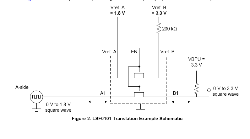

The schematic we use is similar to fig.2 of slva675b,Vref_A=1.8V and Vref_B=VBPU=3.3V, A1 and A2 are inputs, B1 and B2 are outputs, no pull-up resistors on A side and 360ohm pull-up resistor on B side.

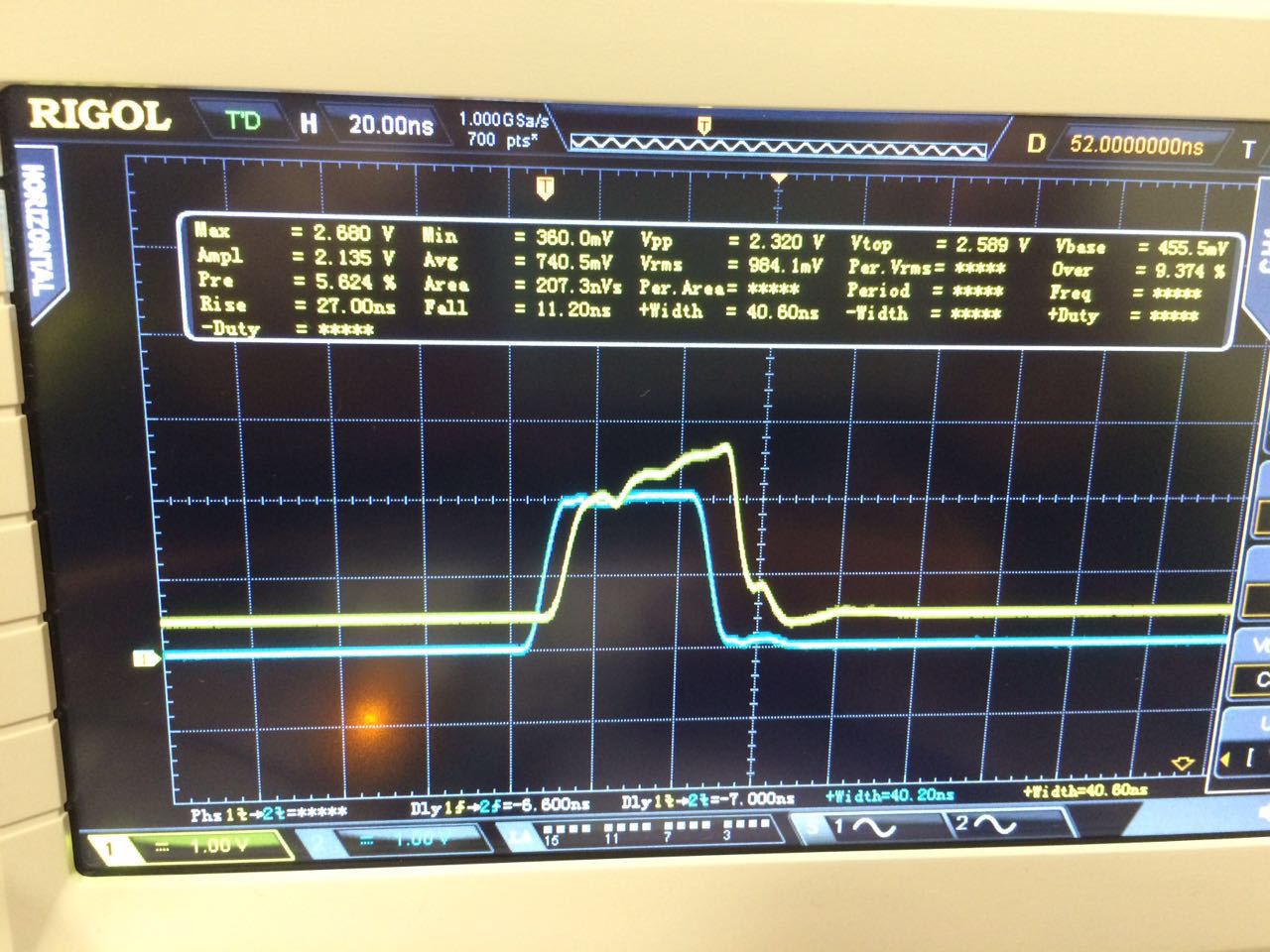

(1)   Input (blue): Pulse wave Vpp=2V, pulse width = 40ns(application requires such narrow width),rising edge=5ns
Output (yellow): low-volatage=0.4V and high-voltage=2.6V, The high-voltage can go up to 3.3V only if pulse width > 120ns

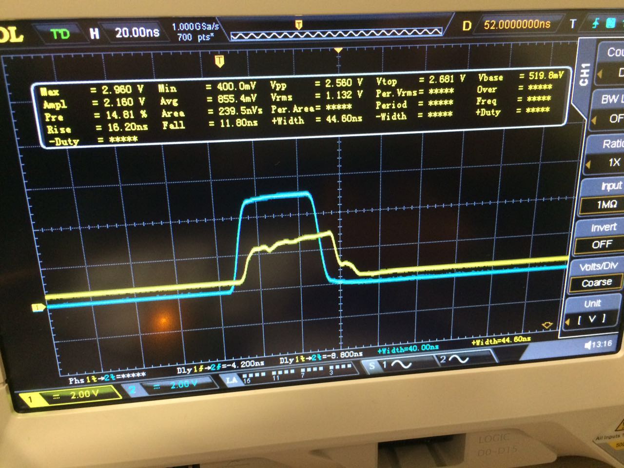

(2)   Input (blue): Pulse wave Vpp=5V, pulse width = 40ns(application requires such narrow width),rising edge=5ns
Output (yellow): low-volatage=0.4V and high-voltage=2.9V, The high-voltage can go up to 3.3V only if pulse width > 100ns

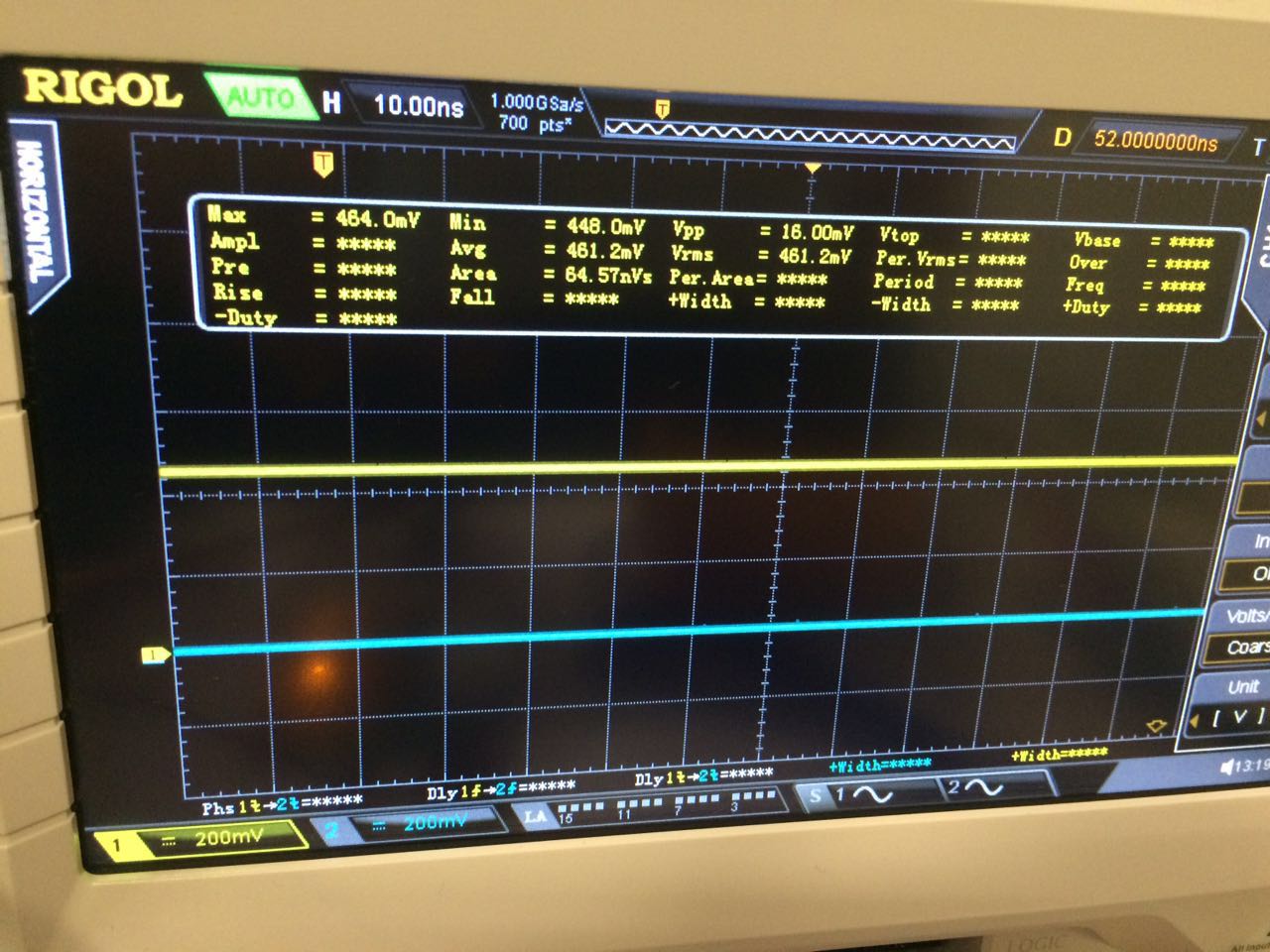

(3)   Input (blue): 0V DC
Output (yellow): 0.45V DC

(3) Is pull-up resistor on A side needed? I am confused because there is no pull-up resistor in fig.2 of slva675b, however in this post
pull-up resistor is needed.

    1) regarding the low output , LSF is a passive translator which passes the low as it is to the output and the high level is through the pullup resistor .When you have the 360ohm pull up resistor at B side , the A side driver must be able to handle the IOL current flowing into it during low state . With the present conditions , it would be 3.3/370 =~9mA . If the input driver is not rated for IOL at 9mA , then the Vol rises . Even if it is rated for 9mA , it will still not be at 0V exactly .
    2) When you say that the 3.3V can be reached with wider pulse width , it presents the speed requirements. The speed is dependent on the output cap load and higher the cap load ,the slower the speed . Ofcourse , it also depends on R . Lower R results in higher speed but also means higher current flowing into A side driver . To achieve the desired speed , lowering output parasitic cap would be desirable if output load cap is constant.

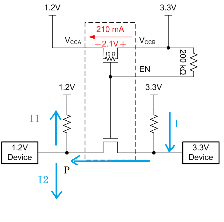

    My input on A side is an TTL device of output impedence=50 ohm, I am not sure it is push pull or open drain. However, If I add a pull up R on A side, the low output on B side goes higher. If I add a pull down R on A side, the low output on B side goes lower. So here is what I thought:
    When input is low, current flows from 3,3V to P point, assume A side driver cannot handle IOL current flowing,
    (1) If a pull up R is presented, I1 will make the voltage of P point higher than 1.2V
    (2) If a pull down R is presented, I2 will make the voltage of P point lower than 1.2V
    So I think a pull down R is needed instead of pull up R, please correct me if I am wrong.

    Essentially , the pulls ups or pull downs are not required if the A side driver is push-pull. In case of open drain , pull ups are required for appropriate level setting .
    The pull ups or pull down will result in additional current into the driver side through it which it needs to handle . If pull ups are used , it would be about the IOL , and with pull downs it would be about IOH .
    If you are satisfied with your high level with the pulldown resistors, you can use this . It should not affect your output low voltage now .
  • I am hoping that you have not connected your circuit as shown in your post resulting in short between 3.3 and 1.2V supplies .
  • Hi Shreyas,
    Thank you for your reply. I didn't short 3.3 and 1.2, I just borrowed the image from another post.
