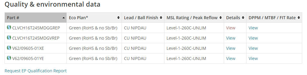

By component grade, I don't believe I understand what you are asking for specifically. The device in question is an EP which is a high reliability enhanced product. Typically this means more stringent testing and a larger sample size. You can see the revalent testing data in the Quality and Support tab
You can also request an EP qualification report by sending an email to the link on the page.

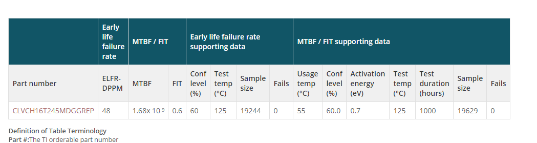

The reliability data is as follows:
Device specific information is as follows, it also lists the lead and ball material of the package:

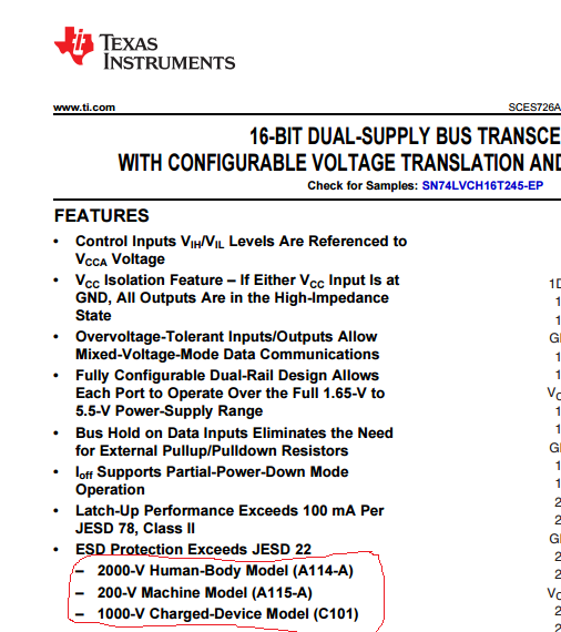

In regards to ESD sensitivity, this is a rating in the datasheet on the first page:
