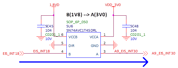

Replace SN74AVC1T45 to SN74LVC1T45
Other Parts Discussed in Thread: SN74LVC1T45, SN74AVC1T45
I would like to replace SN74AVC1T45 to SN74LVC1T45. May I know this changed has any impact?
Attached design schematic in below.
Gary
  • Hi Gary ,
    Functionality is the same , however, the operating conditions and the electrical characteristics will vary .
    I will move this into voltage translation forum for support .
  • Hi Gary
    There are no concerns with the schematic.
    As Shreyas mentioned the functionality will remain the same. Please follow the datasheet electrical specification f or the respective 1.8V and 3.0V. The drive current is higher in the LVC part. The prop delays are much lower in the AVC part. The data rates will be different too.
