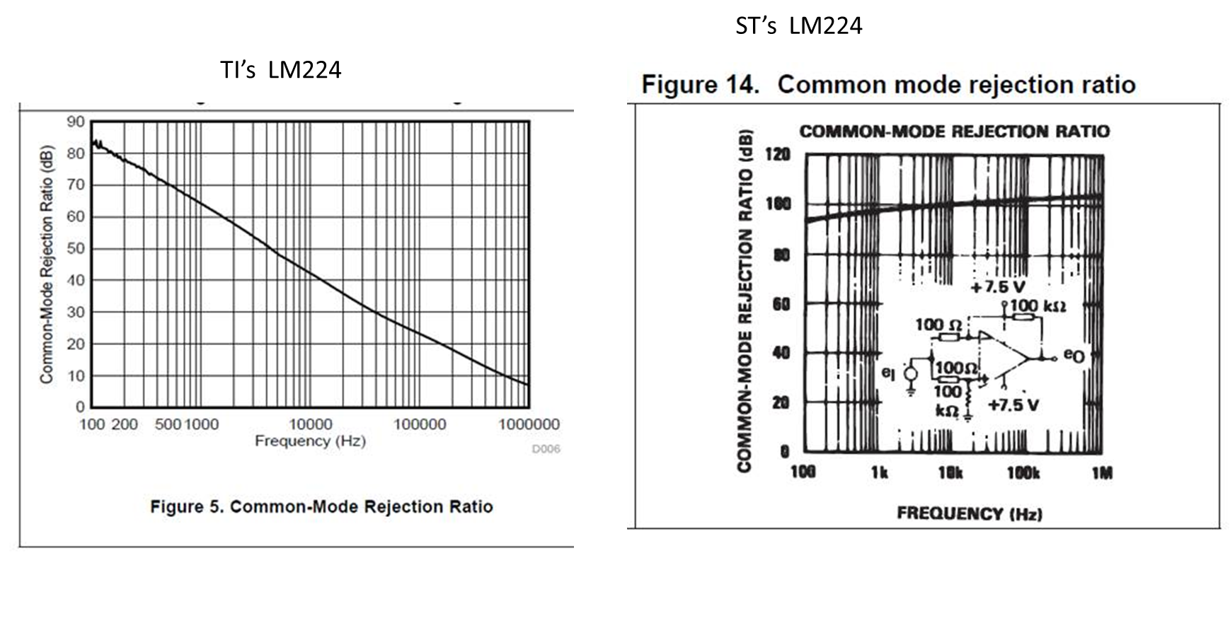

Hi ,
Our customer compared the datasheets of LM224 between TI and ST, and found a strange behavior about the CMRR as below picture.
Can you help check and give some comments why we have so large different?
Thanks a lot.

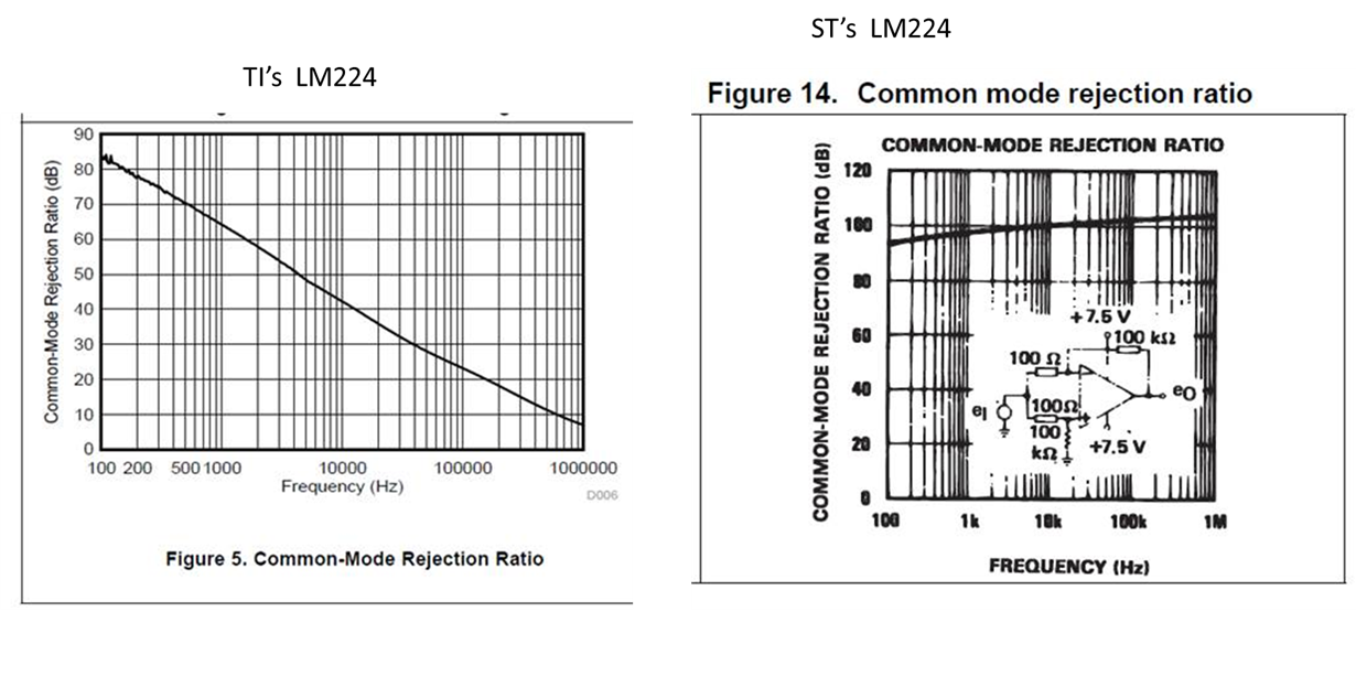

Hi ,
Thanks a lot.

ST's schematic diagram is identical with TI's function block diagram, so in theory, there should be not much of a difference.
(And both datasheets specify the same guaranteed value.)
ST's CMRR does not degrade with frequency, which is either magic really advanced technology, or, more likely, just a wrong curve.
