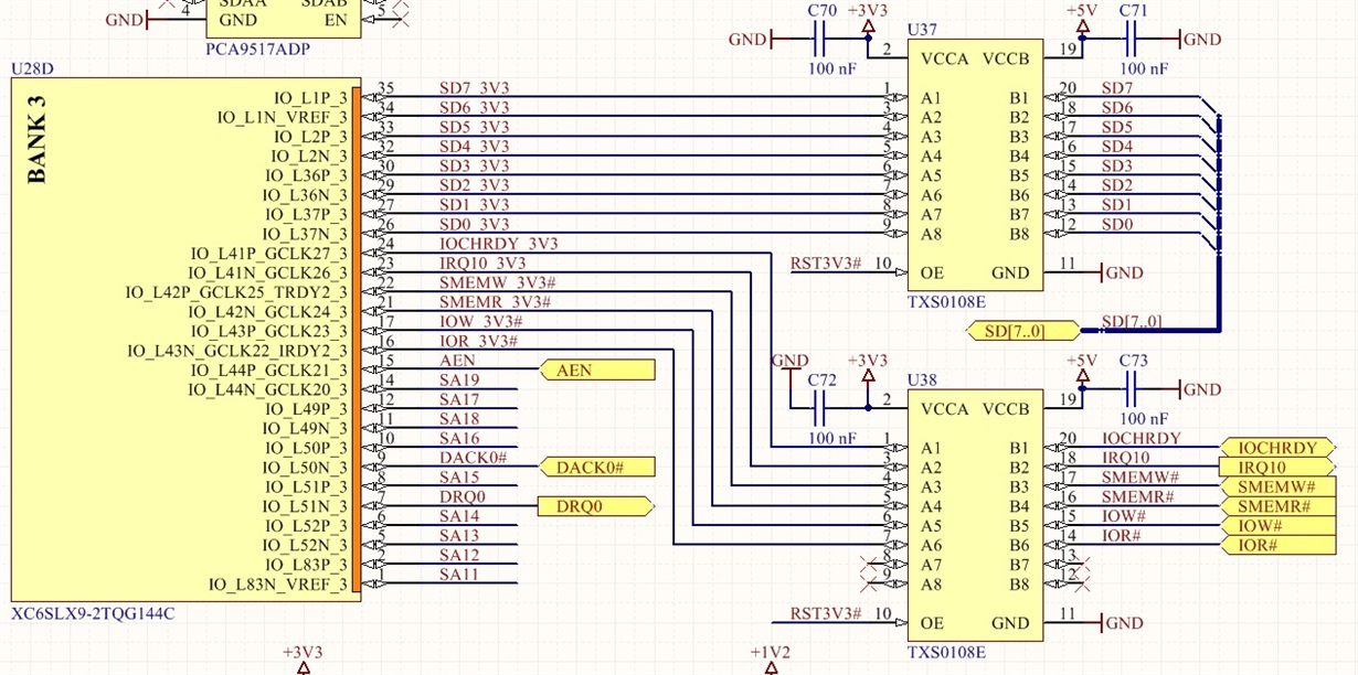

I use a TXS0108E voltage level converter between a Spartan 6 FPGA and a Vortex86DX based processor board. The processor board implements an ISA bus, that is connected to the FPGA. The FPGA is connected to the A side of the converter, Vcca is +3.3V. The processor's data bus is connected to the B side of the converter, Vccb is +5V.  The processor data bus has 4.7k pullup to +5V on each data bus signal.

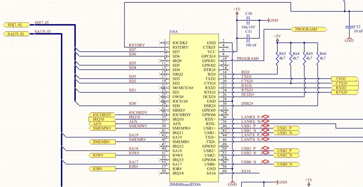

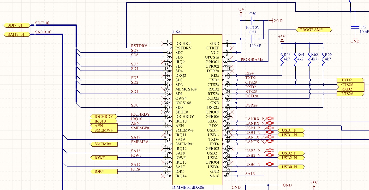

    4. I attached the related parts of the board schematic. J16 is a connector for a SODIMM 144 Socket PC (DIMMBoard DX86), by b-plus GmbH.
