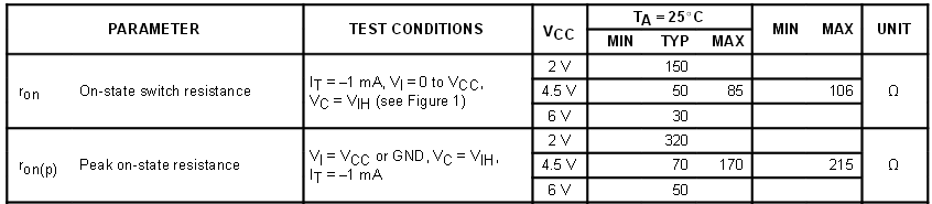

  • Hi Sho!
    The typical on-resitance for the SN74HC4066 is around 50 ohms. See the table below:
    Dennis

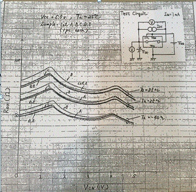

  • Hi Dennis
    Thank you for the reply.
    Yes, I saw this table, butI would like to get graph, because my customer demands it like a following graph.
    Could you give me graph?
    Sho Ogane

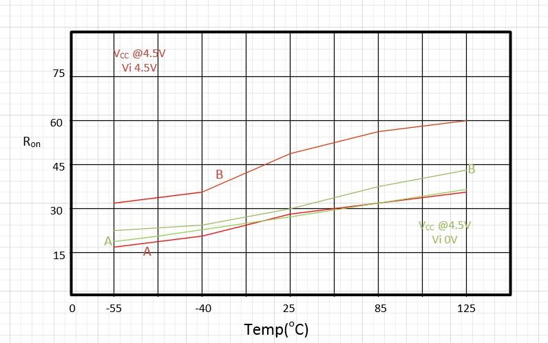

  • Hi Sho Ogane San ,
    Here is the Ron vs temp plot across temp for 4.5Vcc . A and B are different lot data distribution .
  • Hi ShreyasRao san
    Thank you for the graph!
    My customer demands the following graph of 4 SW.
    So please give me it.
    Sho Ogane

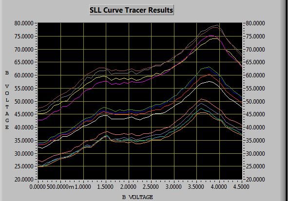

    I will have to search for the device and will try to setup in the lab for giving you the data .
    Please find the temp data attached for Vcc 4.5V , input sweep from 0 - 4.5Vcc , 1mA Iout , 4 devices .
    The top Ron are the 85C temp data , middle group is 25C , bottom group is -40C data .
