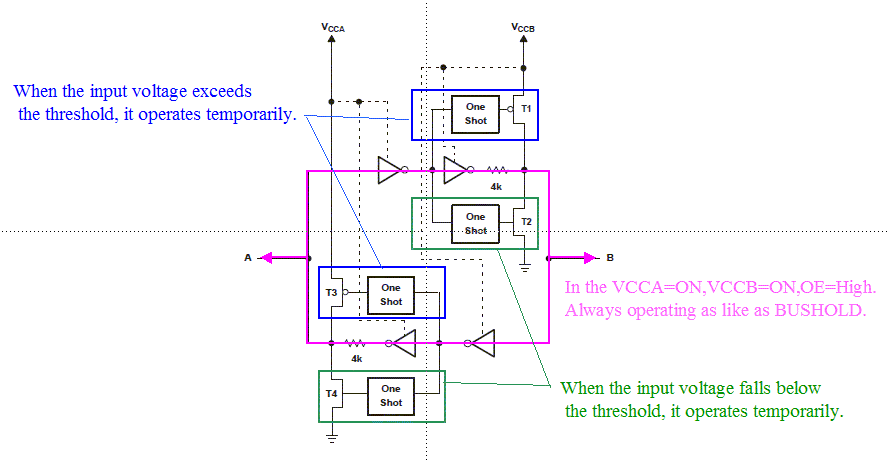

Hello.
Please teach the operation mechanism of TXB0108.
I think that the main buffers other than the One shot buffer of TXB0108 always operate like the bushold circuit.

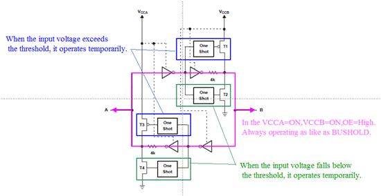

Hello.
