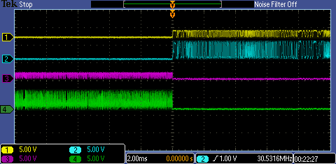

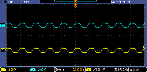

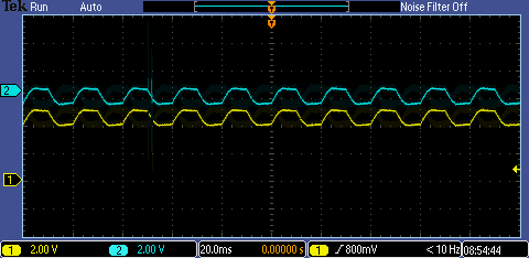

  • Dear Nirav,
    It took a little bit longer than expected to hook up a scope (only one scope here).
    Attached you can see the screenshots of the different states of 2 channels. At first I measured the signal on two channels when the opto-coupler is attached. The signal in high state was really bad. It filled the screen of the scope between 0 and 5V (like a very noisy signal). So to evaluate the output of the TXB0108 I removed the resistor at pin 2 of the opto-coupler (disabeling it). As shown, the level is not a constant value but it seems that the effect between the signals (that I described before) is no longer present. So just attaching the opto-coupler causes the cross-talk effect.
    Do you know if the TXS0108 would help?
    Tim
    Both low
    Both High
    Putting Channel 2 to low should affect channel 1 as it was before. However, it looks like when removing the opto-couplers, the effect is not present.

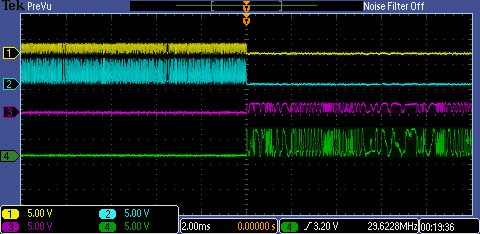

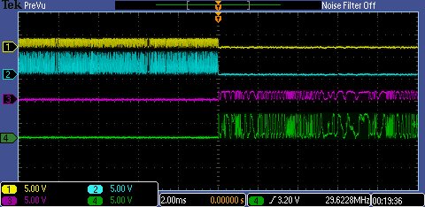

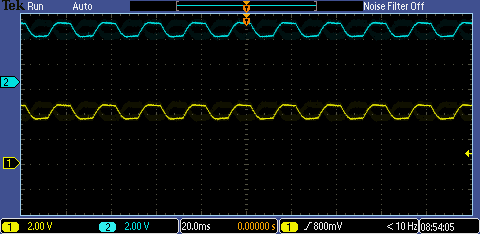

  • Dear Nirav,
    Attached you will find two screenshots. The first one shows the effect on A6/B6 when A5/B5 is becoming high while the second picture is showing the effect on A5/B5 when A6/B6 is becoming high. This means that both can be victim/aggressor. I find the output signal of the 1.8V device to be really noisy but this is only the case when connected to the TXS0108E. Other pins that are not connected to the TXS0108E are having a nice constant signal (both high and low). It looks like there is some strange interaction going on between the GPIO of the device and the TXS0108E.
    The effect is not only present when changing an output from low to high but also from high to low. The only thing that never happens is a signal becoming high by changing another GPIO. So when an output is low it will stay low even when changing the neighboring  signals.
    A5: yellow
    B5: blue
    A6: purple
    B6: green
    A5 to high while A6 is high.
    A6 to high while A5 is high
    PS: The effect is not consistent. It can take a few times before it happens.
    Tim
  • Tim,
    I don't see the xtalk in any of the screenshots. When either Ax pin is toglling, the adjacent Ax pin is idle. When either Bx pin is toggling, the adjacent Bx pin is idle. Are you sure that you have the pin colours labelled right?
    Nirav
  • Dear Nirav,
    No the colours are correct. I have the impression that the TXS0108 switching is affecting the output of the 1.8V device. The output should be constant (when not connected to the TXS it is) rather than fluctuating so mutch....
    Tim
