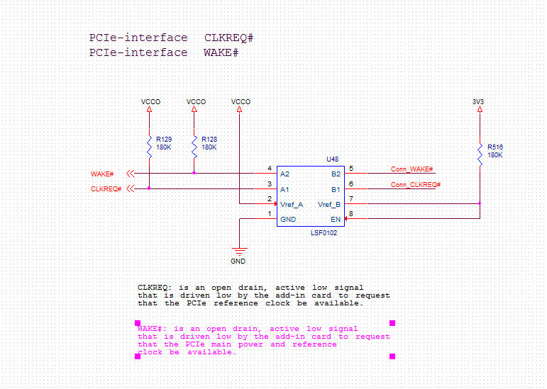

I am looking to do a level translation between 3.3V (open drain) and 1.8V (push-pull)
I am currently using the LFS102 successfully in a design, but I wanted to know if there was a part that you could recommend that would do the same function as the LSF102, but I don't require 3.3V to power the part. I wanted to remove a supply from my design and see if I could use this part to translate between a 1.8V -> 3.3V logic. As can be seen port B is an open drain with a pullup to 3.3V off of my PCB design. I would like to replace the 3V3 with 1V8 to remove the 3V3 power supply.
Is this possible with this part, or do you have another recommendation.

    VrefB is required to operate the part and bias the internal FET to control the device apart from being required for pullup . If unidirectional voltage is concerned , you can consider LV1T family of parts . It works with single supply with high to low or low to high active translation .

    I appreciate the response,but my question is if I can power VerefB and EN with a 1.8v supply instead of a 3.3V supply, but still have B1 and B2 operate with a 3.3V (off board) pullup. This will enable me to remove a 3.3V supply from this area on my PCB.

  • The recommended values of VrefB indicates that there needs to be 0.8V min difference w.r.t VrefA (VrefB >VrefA ) to operate .

    my reason for asking this is so that I can run both VrefA and VrefB off of a 1.8V rail and not need 3.3V. I am finding that the majority of my power supplies for my PCB designs are migrating to 2.5V and below, with many now at 1.2V-1.8V, so if i can remove a 3.3V supply that would help in my layout.
    The 3.3V pullup is located on another PCB through a PCIe edge connector.

    Please correct me if I'm wrong, but from what all I've read so far, it sounds like both lines are uni-directional translation from 3.3V (open-drain output) to 1.8V. This could be accomplished with a pull-up resistor to 1.8V on the open-drain line and no translation device between the two. Am I missing something?
  • Hi Emrys,
    both the CLKREQ# and WAKE# are by PCIe spec 3.3V open drain signals. the pullup resistor is usually on the root complex (mother board)
    Because I am using an fpga with 1.8V IOs, I cannot expose my fpga to a 3.3V signal. I need a bi directional translator because I have to both monitor and control each of the signals.
    Not sure I understand your comment about using a 1.8V pullup on the open drain..

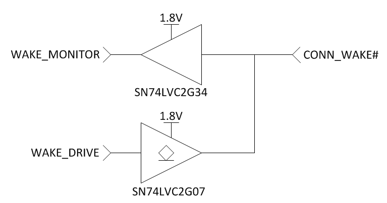

  • Guy,
    Thanks for the clarification.  I believe I have a solution that will eliminate the need for a 3.3V supply on your card with the use of 2 parts.  Basically, an over-voltage tolerant input buffer will be used to read the 3.3V signal, while the line can be driven low by an open-drain output buffer - both of which operate at 1.8V.
    The SN74LVC2G07 can handle up to 6.5V on an output, regardless of Vcc, and contains 2 open-drain buffers.
    The SN74LVC2G34 can handle up to 6.5V on an input, regardles of Vcc, and contains 2 push-pull buffers.
    I have thought of a few ways to do the layout -- this is one option using separate 'monitor' and 'drive' lines.
    Sorry for the crude drawing -- please let me know if I can be of further assistance!
