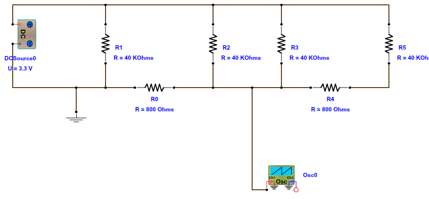

    After your comments, I checked the Electrical Specifications and in 6.3 Recommended Operating Conditions maximum VIL is given as 0.15V whereas in 6.5 Electrical Characteristics, maximum VOL is given as 0.55V. Therefore, should I understand that second TXS0108E may  not see the signal level as low?
    Typical values of R1 and R2 are given as 150 ohms in A Guide to Voltage Translation With TXS-Type Translators  and the value of N-channel pass-gate transistor is given as 300 ohms to 500 ohms in 8.3.1 Architecture of datasheet. Therefore we're talking about a resistance of 600 to 800 ohms. In order not to exceed max VIL of 0.15V, the maximum current will be 187.5uA to 250uA (for 800 ohms and 600 ohms respectively). So, even with two TXS0108E cascaded, if the current exceeds these values, logic low may not be sensed by the second TXS0108E
    When two TXS0108Es are cascaded and the first is driven low, the circuit simply becomes as shown and the voltage at the input of the second TXS0108E becomes 0.186V which is larger than the max VIL. Of course this is a simplified circuit (after fast transition period) but after your comments this is what I guess is happening. Please correct me if there are mistakes in my assumptions.
    Yes. Limiting the current draw when driving a low is what matters. I don't think there is much that can be done about this. The current draw is coming from the 40k pullups from each cascaded TXS0108E. I think the only thing you can control is the input voltage on the first TXS0108E.
    Your schematic looks correct. I got 138 mV instead of 186 mV though.

  • Hi Nirav,
    First of all, thank you for the quick response and extensive lab testing.
    As I see on the second table, a maximum of 96mV is measured on the serial resistance between A and B port.
    Of course this value may differ between individual ICs and resistance between two cascaded ICs may increase due to soldering, routing and connections, which, in the end, will cause an increase in the input voltage of the second IC. Clearly, there's a risk of exceeding the maximum VIL (0.15V) of the second IC. We'll try to find an alternative IC for future applications.
    Thanks again...
