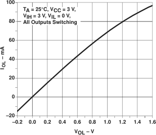

I’m looking at using the SN74LVC1G139 to drive some LEDs directly, but I’m not confident on what the MAX output voltage would be for VOL (Max voltage at the pin when output is driven low).
I’m looking to sink about 5mA at 3.3V. What is a realistic VOL MAX voltage under those conditions?
Thank you
