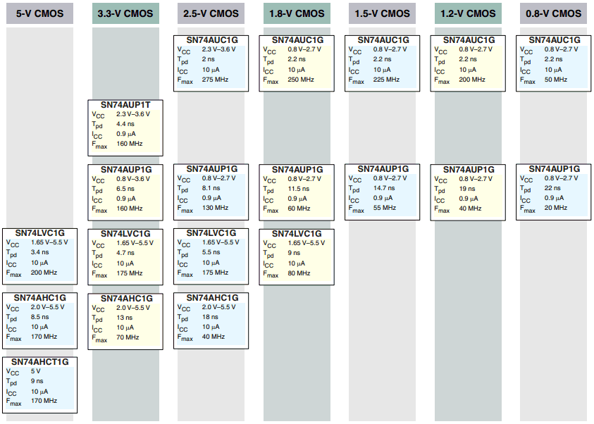

I would like to use a little logic part to buffer a cmos output tcxo.
Which parts would add the least jitter?
Mark
  • What voltage and what drive strength do you need?
    In general, you get the smallest jitter with a device that has the smalled possible propagation delay. So you probably want a buffer from the AUC family, or AUP1T/LVC for higher voltages.

    It looks like the minimum propagation delay choices are SN74AUC1GU04 and SN74LVC1GU04.

  • The SN74AUC1GU04 must not be supplied with 3.3 V. It can tolerate 3.3 V at its inputs, but the maximum supply voltage is 2.5 V.
    And when driving 10 mA, its volage drop would probably be too high.
    The SN74LVC1GU04 at 3.3 V works, if you assume that your TCXO's output actually is LVCMOS (if the VOH value were correct, it would indicate LVTTL).
