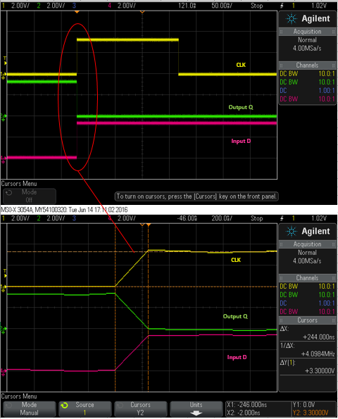

Hi, I am using SN74LVC74ADRG4 as positive edge triggered D flip-flop in my application with output /Q directly feedback to D input. However, the output seems to be correct for the 1st clock (change state at rising edge and output is latched). The output become error when I apply subsequent clocks, it change state at both rising edge and falling edge, which mean output will toggle twice and final state become the same after each clock pulse. Can you advice how can this happen in positive edge triggered flip-flop? Thanks.

  • You might be violating the input transition time of the clock pin with the RC time constant from the pullups being higher than the recommended condition table specifying it to be 10ns/V . A Schmitt trigger device cleans up the slow signal into a square waveform .
    The hold time in uS (for data to be active after positive clock ) is more than enough for the device to work but I am certain that is not the issue you have . what is the setup time you have ? Can you give a zoomed in scopeshot of the clock and input pins ?
  •  Please refer the attachment or scopeshot of the clock and input pins. I will try to add schmitt trigger to clock input signal and make sure it fulfill  10ns/V spec. Will feedback later on the result. Thanks.
  • Hi Shreyas, I have successfully make the flip-flop working properly after adding Schmitt buffer to clock input. However, the best rise time I can get now is 244ns (rise from 0 to 3.3V) which is still much longer than spec requirement, probably due to wire connection or probe capacitance. Actually we are looking for 3.3V D flip flop to replace 5V D flip-flop SN74LS74A. This 5V flip-flop is working properly with initial circuit. I go through the datasheet again for SN74LS74A, there is no mention about input transition rise and fall rate like in SN74LVC74. But both datasheets also mention 'Clock triggering occurs at a voltage level and is not directly related to the rise time of the clock pulse' in the introduction description, which is a bit misleading that rise time of clock pulse is not critical. Can you recommend a 3.3V D flip flop with Schmitt trigger action at all inputs so that it can tolerate slower input rise and fall times? Thank you very much for your prompt support.
