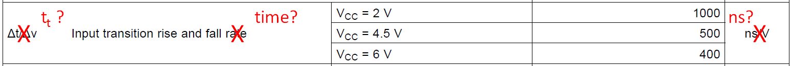

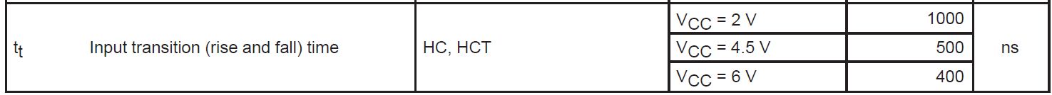

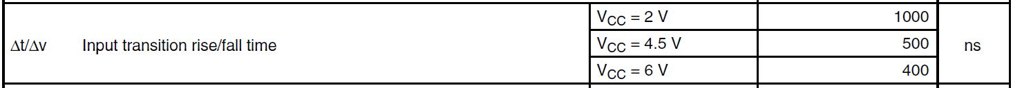

Please let me ask about Input transition rise and fall rate of SN74HC08. There is Input transition rise and fall rate in Recommended Operating Conditions but I'm suspecting that this may be rise and fall time, not rate. Because I found following information from SN74HC08-Q1 datasheet and app note for logic IC.
http://www.ti.com/lit/ds/symlink/sn74hc08-q1.pdf
Implications of Slow or Floating CMOS Inputs (Rev. C)
http://www.ti.com/lit/an/scba004c/scba004c.pdf
