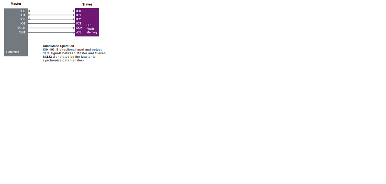

We would like use LSF0204 for Fast SPI signal, some thing need confirm.
1.If we application for Fast SPI signal, do we need external pull up resistor?? because we only saw 100MHz for OD signal, how about PP bandwidth??
2.At datasheet page 13 note "However, if either output is push-pull, data must be unidirectional or the outputs must be 3-state and be controlled by some direction-control mechanism to prevent HIGH-to-LOW contentions in either direction.".If we application is bi-direction, we must use open drain type?
