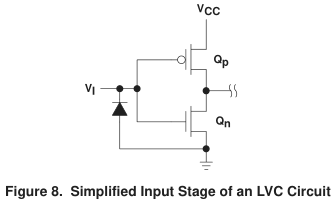

Could you show me the Input equivalent circuit of SN74LVC1G07?
My customer would like to know the leak current when Vcc=0V.
They have already known that the value is specified.

SCBA011 (LVC Characterization Information) has this:
The section "Partial Power Down" says:
To partially power down a device, no paths from VI to VCC or from VO to VCC can exist. With the LVC family, a path from VI to VCC has never been an issue. […]
The Ioff protection is a feature of the output, not of the input. (And for an open-drain output, it does not matter anyway.)
