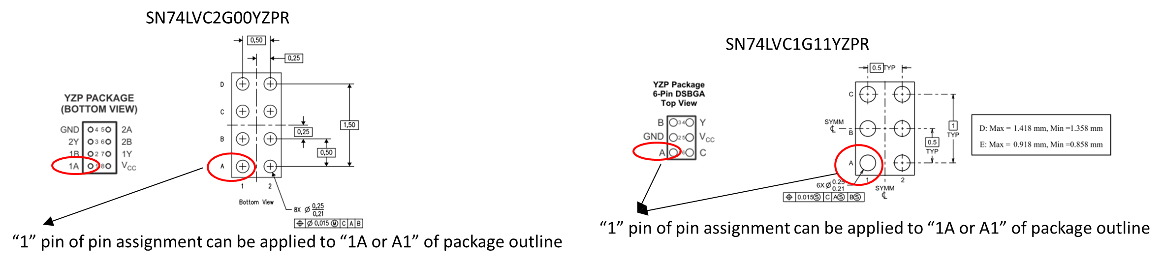

Relationship b/w pin assignment figure and package outline figure
My customer confuse how they apply information of pin assignment to package outline.
The target decices are following two and could you please confirm whether following our understanding is correct or not ?
 Target device :
* SN74LVC2G00YZPR
* SN74LVC1G11YZPR
Is following understanding correct ?
Machida
  • In the pin configuration drawings, "1" is the number of the pin; "1A" or "A" is the name of the pin.
    In the mechanical drawing, "A" and "1" are the coordinates of the ball in the ball grid array. These coordinates have nothing to do with either the number or the name; ignore them. (There is a ball with coordinates "C" and "2", but no such pin name or pin number.)
    All drawings are bottom view, so pin number "1" with name "A1"/"A" indeed uses the ball with coordinates "A" and "1". But this similarity is just by chance.

  • Hi Ladisch-san,
    Thank you for your reply.
    What we want to confirm is whether in the mechanical drawing, "A" and "1" corresponding to "1" (number of the pin) or not.
    Coud you please confirm it ?
    Machida
  • Yes; the number "1" and the coordinates "A"/"1" refer to the same pin.

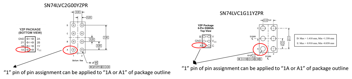

  • Hi Ladisch-san,
    So, the following understanding is also correct ?
    * SN74LVC2G00YZPR
    Pin number : mechanical drawing
    1 : "A" and "1"
    2 : "B" and "1"
    3 : "C" and "1"
    4 : "D" and "1"
    5 : "A" and "2"
    6 : "B" and "2"
    7 : "C" and "2"
    8 : "D" and "2"
    * SN74LVC1G11YZPR
    1 : "A" and "1"
    2 : "B" and "1"
    3 : "C" and "1"
    4 : "A" and "2"
    5 : "B" and "2"
    6 : "C" and "2"
    Machida
  • No, the pin numbers move around the outside in a circular fashion:
    '2G00:   '1G11:
    1: A 1   1: A 1
    2: B 1   2: B 1
    3: C 1   3: C 1
    4: D 1   4: C 2
    5: D 2   5: B 2
    6: C 2   6: A 2
    7: B 2
    8: A 2
  • Hi Ladisch-san,
    I understood and close it.
