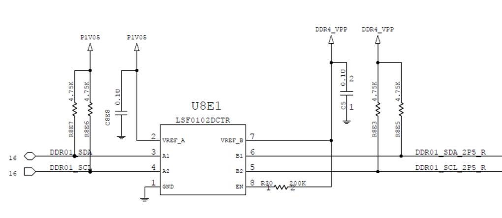

I have a customer with the following scenario:
"I am using the LSF0102DCTR voltage level translator to translate I2C from 1.05V to 2.5V.  I have a mistake in my schematics where the resistor to enable  and vref_b is connected incorrectly.  I recently respun my board and this rev is a possible release candidate.  With the error my DDR01_SDA(SCL)_2P5_R signals swing between 1.5V and GND.   I need the signals to swing between 2.0V and GND.  Is there a reliable way to get an acceptable Vout_high without reworking my board.  Thanks"
His design that he is requesting comment:
He has corrected to below but the above design is a release candidate:

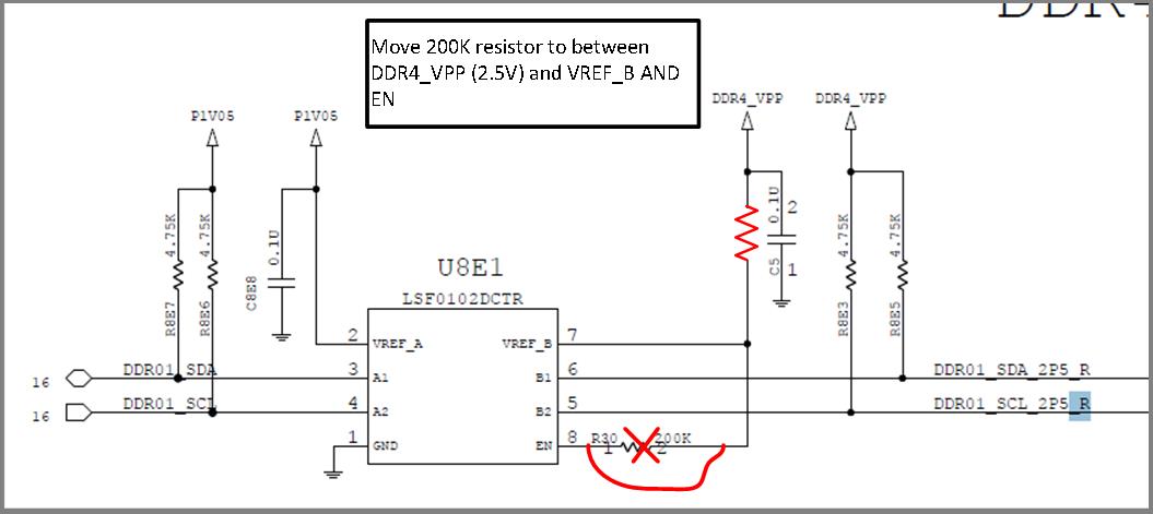

Sincerely,
