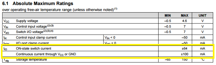

We would like use SN74CB3Q3257 to switching LED.
What is the max passing ( A to B) current. 50mA??64mA?? or 100mA??
If our application need short B1 and B2, I think should be fine. Right??
Thanks for your reply.

Hey Shu-Cheng,
Below is the highlighted portion of the datasheet that answers your questions:
On-state switch current is the max current that can come in/out of any 1 channel that is an IO pin. Continuous current through Vcc or GND is the max current that can come in/out of the device as a whole (All the channels added up).
