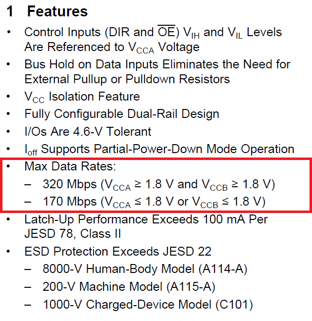

  • Hi Nirav,
    For RGMII maximum clock frequency is 125MHz. But the data rates will be double of clock frequency
    320Mbps(Mega bit per second) is mentioned in the datasheet.Is this the data rate per channel of level translator? For             example 320Mbps for A1 to B1 pin translation?
    Please let me know if we can use the part number for RGMII level translation.
    Bhavya

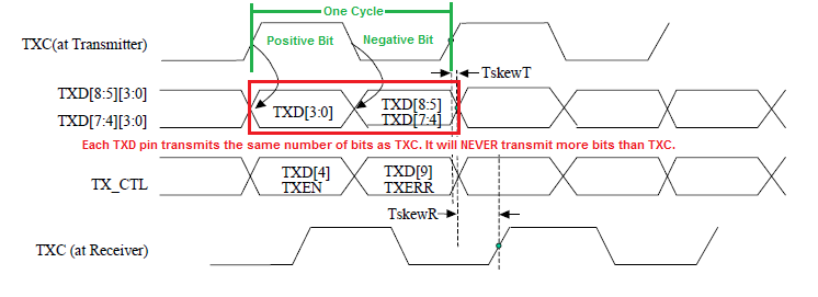

    I read the RGMII Version 2.0 specfication. I do not believe that the data channels would operate at 250 MHz if the clock channel operates at 125 MHz. Instead, the data channels would operate at 250 *Mbps* (or 125 MHz as expressed in frequency).
    Clock frequency = Number of cycles per second
    Bit Rate = Number of bits per second
    One clock cycle carries two bits (Positive Bit, Negative Bit)
    This means that Bit Rate = 2 * Clock Frequency
    The timing diagram below is taken from the RGMII specification (text in green and red is my addition):
    TXC is the transmit reference clock. It operates at a maximum frequency of 125 MHz. This corresponds to a maximum bitrate of 250 Mbps (125 M cycles/second)*(2 bits/cycle).
    TXD is the group of 4 data channels. Notice that there is one bit transmitted with the rising edge of TXC, and one bit transmited with the falling edge of TXC. So in one clock cycle, TXD also transmits 2 bits. This is identical to TXC.
    In short, you can use the SN74AVCH8T245 to support the maximum data rates in RGMII.
