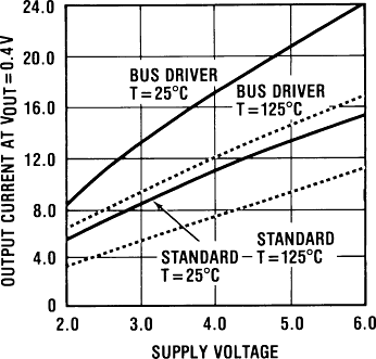

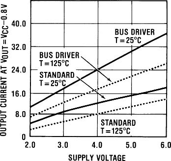

One of my customers is planning on using multiple TI SN74HC164PWR to drive LEDs.  The data sheet specs the output drive at +/- 4mA at 5V.  He is running the chip at Vcc = 3.3V.  What is the output drive at 3.3V?  I checked the data sheet and it doesn't specify the Iout (high or low) with Vcc set to 3.3V

  • Try to extrapolate from the voltages given.
    Or try to derive the maximum values from these typical values:
  • All,
    Where did these charts come from?  I didn't see them in the SN74HC164PWR data sheet.
    According to the customer, he needs I need Iol <= 4mA
