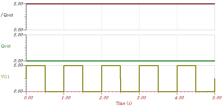

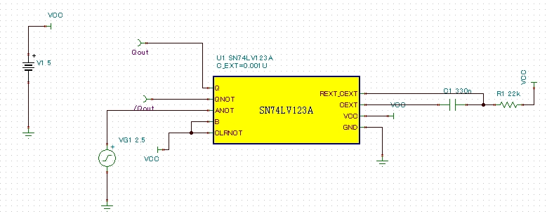

We did the simulation for SN74LV123A with TINA-TI.
Rext=22Kohm, Cext=330nF
ANOT : VG (A=0V_5V, T=1s)
And we got the following result with transient analysis.
[1]. Start 0s, Stop 5s

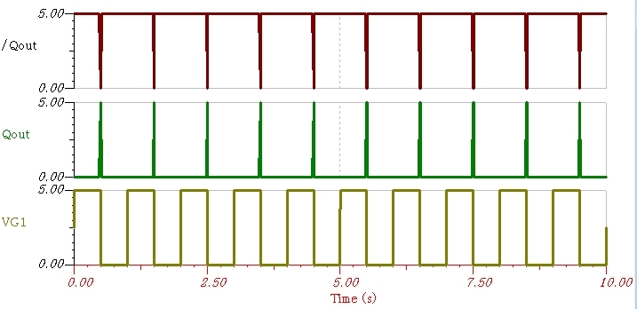

[2]. Start 0s, Stop 10s

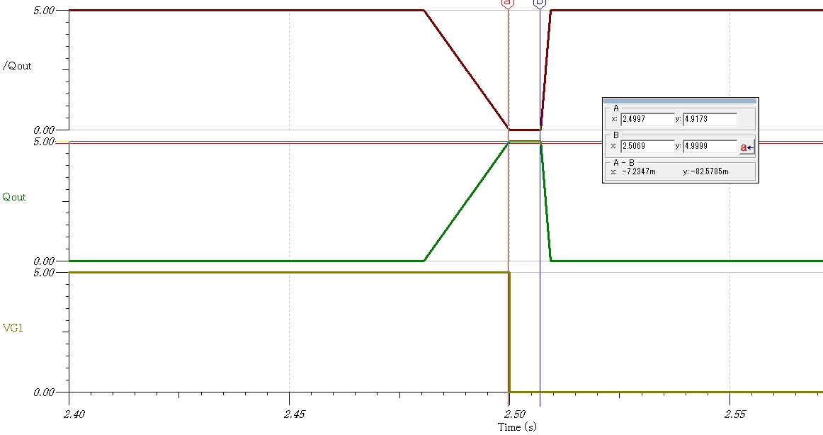

[2]-1. Expansion of  [2], Tw is almost 7.2msec
Question.
1. Why does not the first simulation result [1] show change in output?  Is it strange?
2. We got the result like [2] and [2]-1 with start time 0s and stop time 10s.  That has change in output.
     Is it OK?
3. We got the Tw = 7.2msec in this circuit.  It is matching to calculation result Tw=K*Cext*Rext ≒7.2msec.
    Can you assume this simulation was done correctly?
