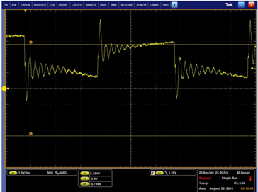

My customer now is using TXB0304 as 3wire-SPI bus level-translator. Since the PCB length is very long, ~3inch, they saw big ringing.
When the output is connected with a 20kOhm pull-up resistor, the output will be as below.

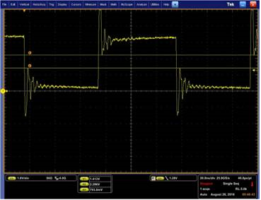

Then they moved away the pull-up resistor and put a 10pF capacitor to the output.  The signal becomes worse.
Do you have any recommendation what to do on the output circuit to optimized the ringing?
