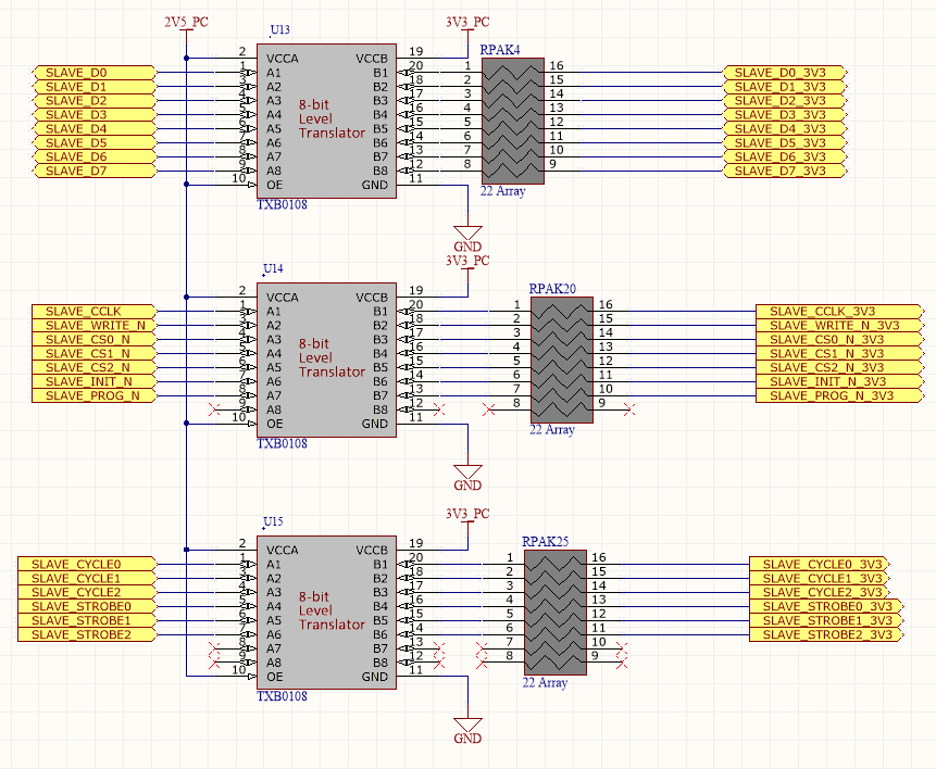

I have used three TXB0108 in my design as shown below.  This is to interface a Spartan 6 @ 2.5V to another Spartan 6 @ 3.3V.  The results have been unexpected to say the least. There are no pullups or pulldowns.  This is just straight logic as shown in the datasheet and application note.  The only functional bit appears to be the clock, but even that looks ugly.  The chip select, for example, will dip from 3.3V to 0 for a second (on the B side) and then float up to ~1.2V.  Don't understand.

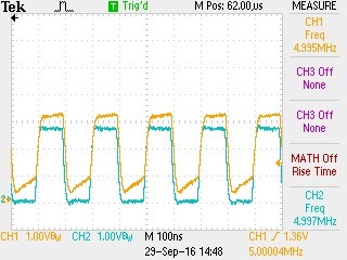

    Simple 5 MHz clock.  2.5V to 3.3V.  If you see, the VCCB waveform does go to 3.3V, but never reaches 0.

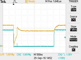

    Before trigger on a chip select.  Looks right.  Input is steady at 2.5V.  Output is 3.3V
    But when active, looks like this.

    I'm kicking myself for not doing what I always did and put 200 ohm resistors in.  This is frustrating.
