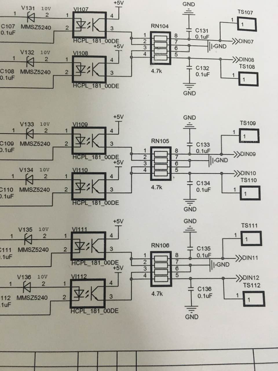

SN74ABT16245A false drive issue in -40C
Hi Team
  My customer is using 74ABT16245 for LED fault indicator, the input is from OPTO iso signal, the output is to drive LED.
  It's normal in normal temperature, but in -40C, the input is low, but the PIN17 (16245A 2B4) has 3.3V voltage, so the output is high, remove the IC it is low again, it seems the input of 16245 force to high.
  Could you help to review the schematic and give us some comments? thanks.
