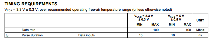

can our TXB0106-Q1 used for QSPI @ 64MHz?
Application is a 5V micro controller interfacing a QSPI Flash with 3.3V.
Josef
  • Hello Josef,
    Based on the datasheet timing requirements on page 5 the TXB0106-Q1 will only support a data rate of up to 100Mbps (roughly 50MHz).
    I noticed you are using a Q1 part. Does the part need to be automotive qualified? Also, as SPI interface is generally fixed, does your application require an auto-direction sensing translator? This can help us narrow down a part that will meet your needs.

    As discussed offline, TXB0106 would be the correct choice for QuadSPI. In your application, the maximum data rate of 64 MHz is not supported by the TXB0106. I would suggest looking at the TXB0302 or TXB0304 instead.

    This would call for an auto-direction sensing translator. The TXB0106 would be the best fit if the data rate is 100 Mbps or less.
