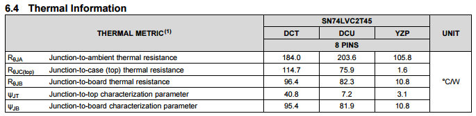

What is the Junction-to-case Thermal Resistance (Theta - JC) and Junction-to-ambient Thermal Resistance (Theta - JA) for the device SN74LVC2T45MDCTTEP ???
