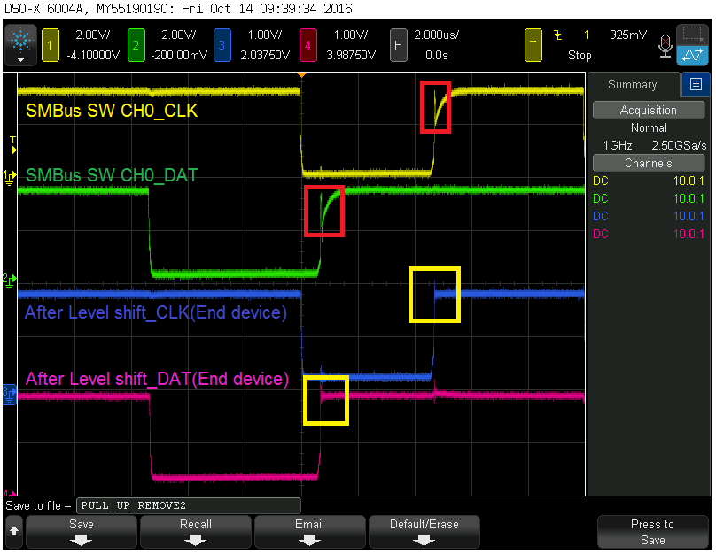

We got two issue on TXS0102 application. Schematic (pic1) and waveform attached, please help to give some suggestion, thanks.
1. There are a voltage surge on both CLK/DAT when communicate(pic2). We remove TXS0102, and the surge disappear(pic3). How to solve this surge?
2. The input Vlow level is 0, but output Vlow is not 0. How to solve this?
