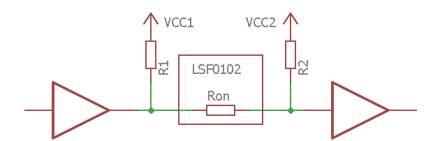

The customer wants to get some information for LSF0102.  The customer is using the part for translating MDIO/MDC lines.
What is the value of VIH VIL VOH VOL when VREF1 =1.2V & VREF2=1.8V for LSF0102?
  • This device does not actually pass through digital signals; section 8.3 of the datasheet says:
    When the An or Bn port is LOW, the switch is in the ON-state and a low resistance connection exists between the An and Bn ports.
    This is essentially an analog switch.
    In the high state, no current flows (except some leakage current).
    To get a low signal on an output, whatever device is connected to the corresponding input must have enough drive strength to pull the entire signal line low, which means it must be able to sink the current through any pullup resistors and the switch resistance:
    So to determine the voltage at the output, you need to know VOL of the driver, and the values of all the resistors.

  • Hi Mickey ,
    LSF is a passive translator , it does not have a Vih Vil Voh Vol specified on it since it doesn't have a drive of its own.
    As explained by Clemens ,the driver must be able to sink all the current through the pullup resistors and still be able to maintain the low level.
    for eg: Driver is rated at 0.4V at 16mA , then the output low level of LSF will be 0.4V(max) when 16mA of current is being sunk into the driver. Any more current will increase the Vol beyond 0.4V .
