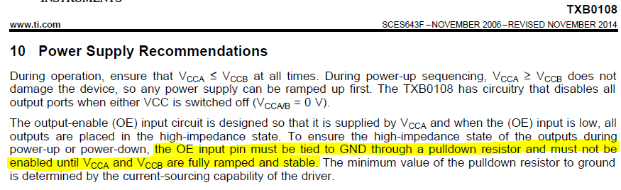

In the datasheet, it stated the below (highlighted):
What will happen if OE is enabled before both Vcc fully ramped and stable?
Thanks.
- YY
