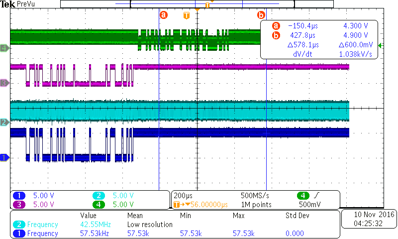

A TXB0102 is connected as a 3.3V to 5V level shifter between an Altera MAX10 (Dkey 544-3145-ND) and a FTDI TTL-232RG-VIP-WE (Dkey 768-1069-ND).  The signals are '232 TX and RX.
The RX side of the level shifter to the FTDI cable oscillates at 40MHz when the system is powered up.  Sometimes the oscillation waits to start after the first packet.
It is as if there is a contention, but there is no known contention.  Have other users of this level shifter seen this problem?  The TI IC is meant to auto-detect direction.   We don't know the IC details of the FTDI circuit receiving the oscillating output signal. The I/O on the Altera are set to 8mA I/O drive.
CH2 light blue trace is the '02 oscillating output.  The CH2 light blue trace should be following as a 5V level shifted version of the 3.3V level on CH4 green trace.
  • In theory, the Altera's output should be string enough for the TXB. But it's possible that some pull-up resistor is too strong (see SCEA043).
    Anyway, you do not need an auto-direction sensing translator for unidirectional signals. Up translation can be done by any buffer with TTL-compatible inputs; down translation can be done by any buffer with 5 V tolerant inputs. The SN74LV1T34 has both.

  • Hello Tim,
    Yes, I agree that you do not need an auto-direction translator. These translators are very sensitive to output capacitance especially at higher frequencies and I would assume the 1.8m cable exceeds the 70pF limit of the TXB0102.
    I think the LCV would meet your requirements. It is available in dual control packages but only in 16 bit configurations. I will notify an engineer who handles our other translator portfolio to see if they have anything that meets your needs.
