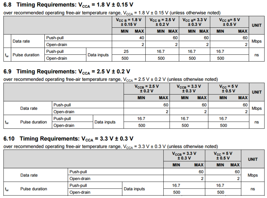

Can TXS0108E support I2S @1.4MHz or higher? what's the data rate? what's the driving condition type?

Hello Stanley,
The TXS0108E can support 1.4MHz. We can see the data rates in the following tables from the datasheet. A general rule of thumb is to divide the data rate by 2 to obtain the comparable frequency. So a frequency of 1.4MHz would be approximately 2.8Mbps. Since I2S is a push pull interface it will be able to handle this data rate. I am not sure what you mean by the driving condition type. Can you elaborate on this?
